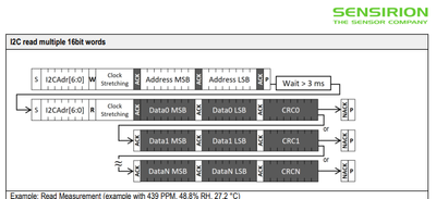

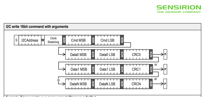

Link to the protocol document. Sending 12 bytes seems a bit odd. IMHO
here is the link to the sensor and here is the link to the protocol document. I found another person's example code and took the 12 byte buffer from that. if you look on page 8 of the linked SCD30 document, using the HAL i2c function, I would be sending 5 bytes of data, CRC included. I think that's the part that's messing me up. I haven't been able to reproduce the example CRC with any calculator or example code and this MCU does not have integrated CRC functionality.
So the sensor supports I2C, MODBUS, and PWM - are you sure you have it in the correct mode?
The transmit is only 11 bytes of data: the I2C Address is specified separately - not included in the buffer:
For receiving, it's (up to) 9 bytes of data:
The sensor datasheet shows example scope traces - compare them to what you're seeing.
@JustSomeGuy wrote:
 I haven't been able to reproduce the example CRC with any calculator or example code.
Not even the sample code given by Sensirion on their Product Page for this sensor?
https://sensirion.com/products/catalog/SCD30/
https://github.com/Sensirion/embedded-scd/releases/tag/2.1.1
I'm familiar with I2C protocol, used to work for Philips Semiconductor..
The protocol for the sensor doesn't send 12-bytes in any circumstances.
It sends a 16-bit command, and then multiples of 3-byte parameters, ie 16-bit data + 8-bit crc.
So 2, 5, 8, 11,.. etc bytes per interaction. Didn't look at the Read methods
The CRC is described, and can be computed in SW, with low effort.
Oh dang I didn't even see those. I'll give it a shot!
I see. so how would i integrate that with the HAL for i2c? would I send the 3-byte parameters as a separate write command?
yeah i've been following along with those since the beginning. the thing i'm caught up on is how to format the data the right way and send it with the HAL drivers. as for the mode, is the default mode not i2c? I assumed so because on the inferface description, it only says how to set it to Modbus or PWM mode.
As I read it a singular 5-byte write transaction.
