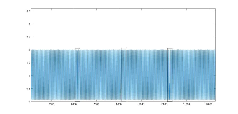

I am working on a project in which I have to store the data from my ADC (in continuous mode with DMA) on a SD card (with FATFS and SDMMC1) without losses. I try to use a ping pong buffer but when I want to change the bufferinwhich the ADC store values I have to stop my adc and restart it with the good buffer in parameter. Thus I lose a lots of data because of that.
Do you have a better solution to this matter ?
I also use my SD card in 1 bit mode because when I want to use it in 4 bits mode I have the RXOverrun flag. Fatfs is not configure to work with DMA because I don't know how to do it.

Thank you for your help. DMA was already configured in circular mode and even if it is better than before, when I store at half-complete and transfer-complete interrupts I still lose datas when I change the buffer (in the black rectangles on the photo)0693W000003Ov0hQAC.jpg.
waclawek.jan
Using HAL_ADC_Stop_DMA() / HAL_ADC_Start_DMA() defeats the point of circular DMA. You don't want to stop/start ADC/DMA.

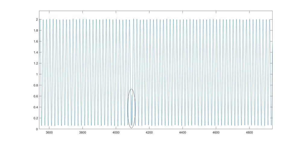

This seems to be better, but I still have some losses like on the photo. I am wondering if it could come from the writing speed of my SD card which is to slow. More I don't use 4 bit mode for SDMMC1 because I always have Rx overrun error :grinning_face_with_sweat:.
***EDIT***
The "losses" seem to come from ADC because I have "glitches" like in the photo even in the middle of the half part of the buffer for exemple.
Thanks for your help :D 0693W000003P8BsQAK.jpg
