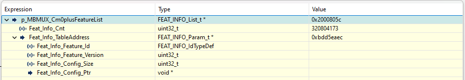

When running second core initialization, the program goes into HardFault on line "i_feature = *(i + p_MBMUX_Cm0plusFeatureList->Feat_Info_TableAddress);"
The code was automatically generated by CubeIDE when opening the ST program "SubGHz_Phy_PingPong_DualCore"

The structure has values but still crashes when i read from it.Captura de ecrã 2024-07-19 153407.png

Hello @AlexandreMagno
Could you please give more details (are you using your own design or the B-WL5M-SUBG1, have you followed the run/debug steps mentioned on the readme file of the Project) I'm not able to reproduce this on my B-WL5M-SUBG1.
