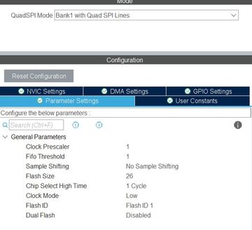

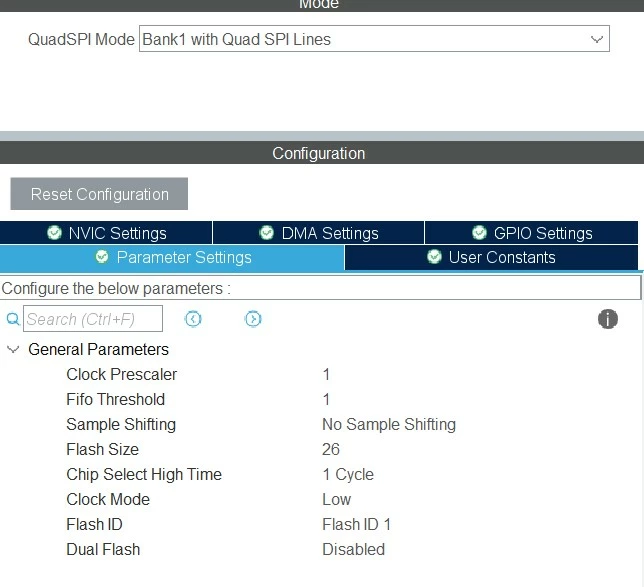

I have been trying to make a driver for the Winbond(W25N01GV)  NAND flash over QSPI but I've been failing so far. Can somebody give me some ideas about what I am doing wrong?

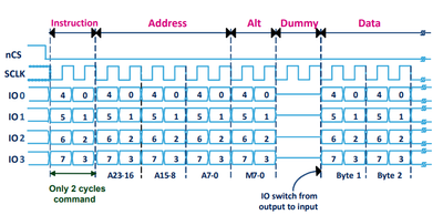

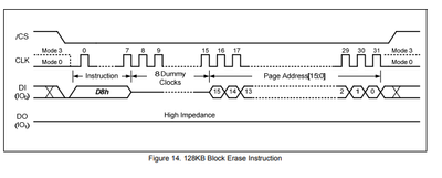

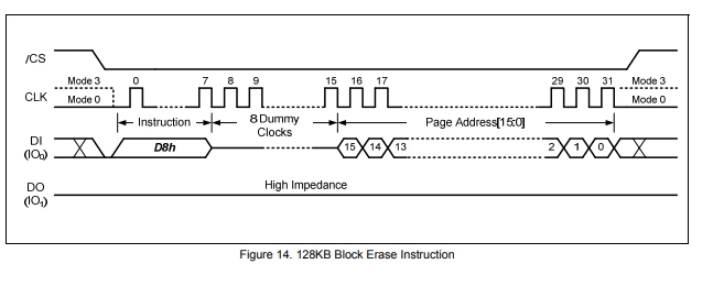

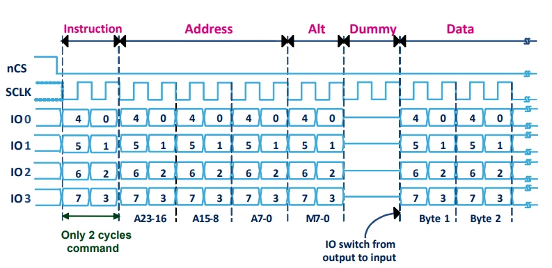

NAND memory are supported if the command format is in line with the QUADSPI controller frame format (AN4760):KDJEM1_1-1699883207305.png
But, according to the memory datasheet, Block Erase (D8h) command needs the address after the dummy bytes.
Thank you.
Kaouthar
DracuAuthor
November 13, 2023
Hello @KDJEM.1 ,
That is why I am sending the address after the dummy clocks with:
HAL_QSPI_Transmit(&hqspi, block_add, 1000U) != HAL_OK)
