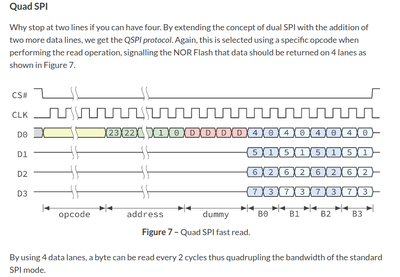

I have a very strange issue with QSPI peripheral. I am using it to store logs in external memory.
The flash that is used is MT25QL256ABA with a custom STM32WB55 board. I have connected PModSF3 using jumper wires that are at least 15cm long.
Issue: When I use the FAST READ (single data line, 1-1-1 mode), it works perfectly fine. I am able to validate it with the hex dump of a buffer that writes ASCII (0-9). But when I use it in QUAD OUTPUT FAST READ (1-1-4), I get some missing data that is probably shifted.
I have specified two dummy cycles based on the datasheet. Tried increasing it, does not make much of difference.
But reducing the clock speed by a factor of 100 seems to help, but then quad mode is useless.
The code is based mostly from the ST examples.
Can anyone help me in figuring out the issue? I can provide more data if needed.

This external flash also has a 3-byte addressing mode too. With which the upper or lower 128Mb can be used based on the configuration in volatile registers. I have interfaced this flash in SPI mode, it works really well.
Only the QSPI interface has issues when used in 1-1-4 mode.
I have increased the Dummy cycles from 2 to 10, yet there is no difference. Should I go even higher?

When the bytes are different (random), it fails to read. Almost seems like the data lines are pulled up and they stop working. The idea behind writing 0xAA or 0x55 is to see if all the lines are working as expected. Which to me seems like it is working well.
Now, when I change the code to write an arbitrary pattern, it fails.

So perhaps clock phase or edges? Especially as the data desync's as you proceed.
This is a MT25 not a older N25 ?
I linked for thread context, mainly to confirm what you wired. I didn't find a circuit diagram, assuming pull-ups on the signals.
I tend to use ZIF fixtures so I can test different parts readily.
2024-10-20 9:26 AM
@Tesla DeLorean wrote:So perhaps clock phase or edges? Especially as the data desync's as you proceed.
I can only assume so, as I do not have a logic analyzer to debug it. But what would be the reason that all the IO lines stay at logic high (resulting in 0xFF)?
