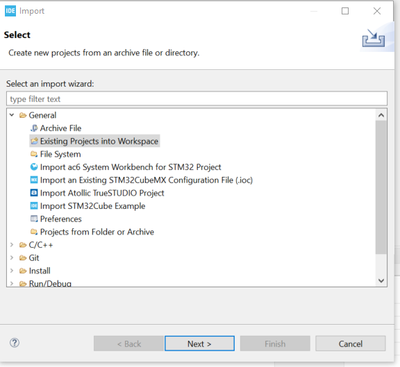

Could you please open .cproject file or call it directly using the import project of the STM32CubeIDE.
Best Regards.
STTwo-32
I tried clicking on the .cproject itself and it did not open in CubeIDE.
Which option should I select to open it from the Import option?
Could you please try to import it using the following Methode:
Go to File > Open Projects from File System... > and select the directory of your project. After that, on the Folder file select the STM32CubeIDE folder. "
