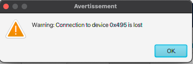

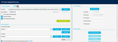

I am currently working with the STM32WB Nucleo Boards. I wanted to flash the stm32wb5x_Zigbee_FFD_fw.bin on the Dongle. However, when I start the firmware update, this message appears:
Here the firmware upgrade service window:
Does anyone know a solution to that issue?

For downloading the Stack library I used :
git clone --recursive https://github.com/STMicroelectronics/STM32CubeWB.git
The procedure I have been using:
After putting the Dongle switch to BOOT0 I connect it to the Cube programmer with USB.
And in the Firmware Upgrade Services tab I juste put my Stack's file path and click on Firmware Upgrade.

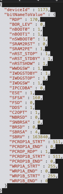

2024-10-18 9:35 AM
2024-10-18 9:48 AM
They are not really visible here.? Could you please use the GUI of CubeProgrammer.

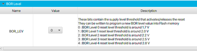

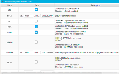

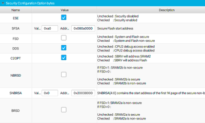

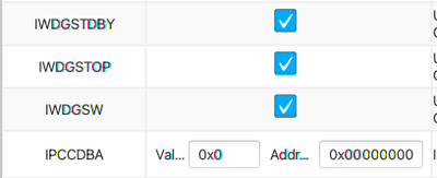

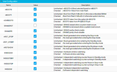

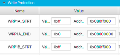

Ok I'm sorry @STTwo-32,
Heres the options bytes:
BOR LEVEL:
USER CONFIGURATION:
SECURITY CONFIGURATION OPTION BYTES:
PCROP PROTECTION:
WRITE PROTECTION:
Best Regards.
