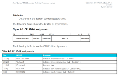

I read and display the CPUID and REVID on my project.
I see the difference between using an U575 chip vs. U5A5 chip (NUCLEO boards):
U5A5:
CPUID: 0x410FD214
REVID: 0x30016481
U575:
CPUID: 0x410FD214
REVID: 0x20016482
OK, based on ARM Cortex-M33 documentation: the same CPUID makes sense (and it is the same on different boards): the 214 at the end means: CM33 (the 41 should be the vendor).

Hello @tjaekel
Sorry for the inconvenience. CPUID registers are detailed in the Arm® Cortex®-M33 Processor Technical Reference Manual

"Check section 76.1 in the reference manual: Unique device ID register (96 bits)" (not seen here as response, but I got it in my email) - it is NOT what I was talking about (I know this register: useful for USB IDs, ETH MAC addresses, ... I have used already on other projects).
Yes, I know this ARM document where I can figure out it is a CM33 (this 0xD21). The CPUID is clear for me.
