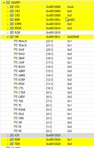

What I have noticed is if I clear the flags before checking the RXNE flag, then the RXNE  gets cleared.  If I put at the end then works as expected. I am thinking I dont even have to check this flag as I dont use this feature.
void USART1_IRQHandler(void)
	unsigned char data;
	if(USART1->ISR & USART_ISR_FE)
	  USART1->ICR |= USART_ICR_FECF;
	if(USART1->ISR & USART_ISR_EOBF)
	  USART1->ICR |= USART_ICR_EOBCF;  <<this clears the RXNE bit
	if(USART1->ISR & USART_ISR_RXNE)  //RX interupt
		data=USART1->RDR;
Below is the snap shot prior to moving the above to the end..
Best Regards
Scott
