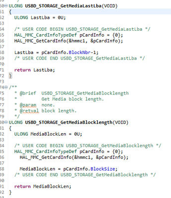

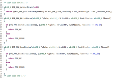

I want to use the EMMC as USB storage space, but I encountered another issue: I am trying to access the EMMC via SDMM1, and after implementing the MSC-related functions (read, write, USBD_STORAGE_GetMediaLastLba, USBD_STORAGE_GetMediaBlocklength) in ux_device_msc.c, the formatting operation on the PC side fails. The error message says: "Please insert a disk into the removable disk."
I have already verified that after initializing SDMM1, the EMMC can be accessed and read/write operations are successful.
What could be the reason for this issue?

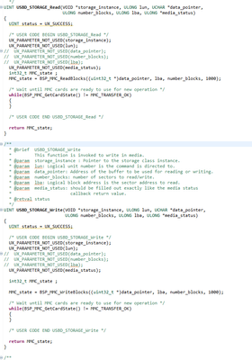

Honestly it took me sometime to realize to never use status = UX_SUCCESS; and use  status = UX_STATE_NEXT; instead !
Now, here is a working example for eMMC !

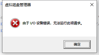

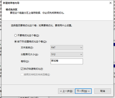

I can see an unallocated Disk 3 in Disk Management(3.64GB), but when trying to format it(FAT,size=512), I get the error: "The request could not be performed because of an I/O device error."

I modified the read and write functions in ux_device_msc.c, but the formatting still cannot be performed correctly. Through GDB debugging, I found that during formatting, write operations are executed and the data is written correctly, but the formatting still fails.
