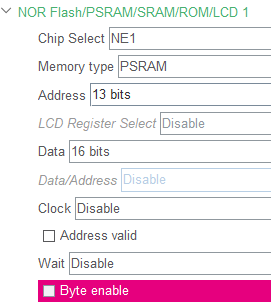

I have a issue to control IS66WVE4M16EBLL-70BLI with STM32U585AII6.
Although IS66WVE4M16EBLL-70BLI is 8MB, I can read and write only 8KB.
IS66WVE4M16EBLL-70BLI has 22 address lines and 16 data lines.(4M * 2 = 8MB)
The problem is
if i change 2-byte at address 0x60000000 to 0x7777, 2-byte at address 0x60002000, 0x60004000 ... also changed to 0x7777.
My guess is
fmc tries to write data to 0x60002000, 0x60004000... but it writes to data to 0x60000000.
Also fmc tries to read data from 0x60002000, 0x60004000... but it reads data from 0x60000000.

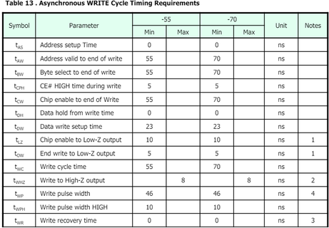

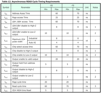

MCU clock is 160MHz. so 1 clock = 6.25ns.
PSRAM time is below.

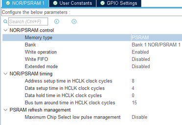

 My Cube configuration is below.
Here is configuration.

hsram1.Init.NBLSetupTime = 0;
hsram1.Init.PageSize = FMC_PAGE_SIZE_NONE;
hsram1.Init.MaxChipSelectPulse = DISABLE;
/* Timing */
Timing.AddressSetupTime = 8;
Timing.AddressHoldTime = 0;
Timing.DataSetupTime = 4;
Timing.DataHoldTime = 0;
Timing.BusTurnAroundDuration = 15;
Timing.CLKDivision = 16;
Timing.DataLatency = 17;
Timing.AccessMode = FMC_ACCESS_MODE_A;
