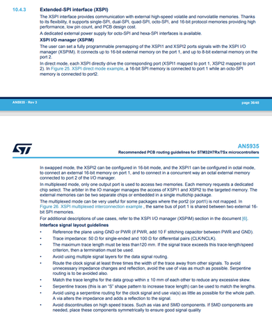

For sure, I connected the programmer to configure the sbs since the VIO is 1.8V. What I missed from the HW was that I forgot to add the pull-up resistor at the CE pin. Note: I desoldered from the original ST board to check the behaviour and did not influence its behaviour. The reset is connected to the NRST by a diode. Note: Checked the connections, footprints. GND is on the mid1 layer and all of the connections are on the top layer. The length is less than 14mm and the distance between the track are usually 0.2~0.25mm.

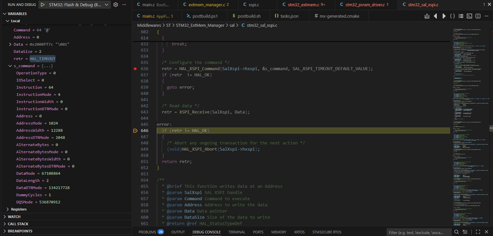

staus_psram return with EXTMEM_ERROR_DRIVER and it came from the HAL TIMEOUT from STm32_sal_xspi.c
XSPI_Receive somehow returns with HAL_TIMEOUT. I increased the timeout to be 1000, but without any success.

  /* Configure the command */
  retr = HAL_XSPI_Command(SalXspi->hxspi, &s_command, SAL_XSPI_TIMEOUT_DEFAULT_VALUE);
  if (retr  != HAL_OK)
    goto error;
  /* Read data */
  retr = XSPI_Receive(SalXspi, Data);
error:
  if (retr != HAL_OK)
    /* Abort any ongoing transaction for the next action */
    (void)HAL_XSPI_Abort(SalXspi->hxspi);
  return retr;

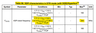

The XSPI clock speed 200MHz is the maximum clock speed supported. You must therefore respect the hardware and the software constraints to achieve this frequency.
For that I recommend you to refer to Getting started with STM32H7Rx/7Sx MCUs hardware development - Application note application note to check you hardware:
