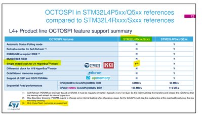

According the erratasheet and STM32L4Plus-Peripheral-OctoSPI interface (OCTOSPI) all the PSRAM memories are not supported in the STM32L4R9 products including the HyperRAM memories, We support only HyperFlash memories.
So we recommend you to use a parallel memory using FSMC or if possible to switch to the STM32L4P5/Q5 products in which the OCTOSPI support PSRAM memories including HyperRAM.

Hi @KDJEM.1 , thank you for the update this helps in making a right decision. we are just curious how it is that there is support for hyperbus flash but not ram or psram and can you please provide the link to this information any pdf link will help. there is a much more crucial thing i want to bring to your attention I have a eval board and with macronix flash memory the examples and template projects for this are missing and what exists does not work .

-we are just curious how it is that there is support for hyperbus flash but not ram or psram and can you please provide the link to this information any pdf link will help.
You can find this information in:
The erratasheet : STM32L4Rxxx and STM32L4Sxxx device errata - Errata sheet
The product training: STM32L4Plus-Peripheral-OctoSPI interface (OCTOSPI)
Thank you.
