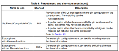

Hi @RicOs ,
I join @Andrew Neil with the idea to use STM32CubeMX.
From Pinout tab, STM32CubeMX allows to export the pinout to a csv file. You can select any STM32 part number then do the required export. This is explained in the UM1718:
-Amel
-Amel

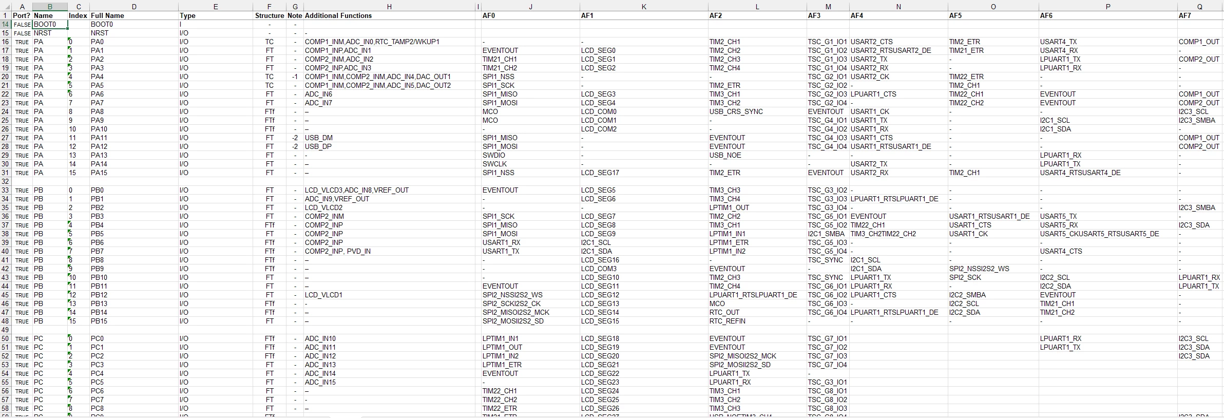

Does/can the CubeMX export actually give a full listing of all a part's pins?
It seems to only list the ones that are actually used by a project, as used by that project?
So not a complete listing of all the pins with all the AF options and all the Additional Function options?
Andrew Neil
Jan 15, 2025 11:51 AM UTC
@Amel NASRI something like this - see attached

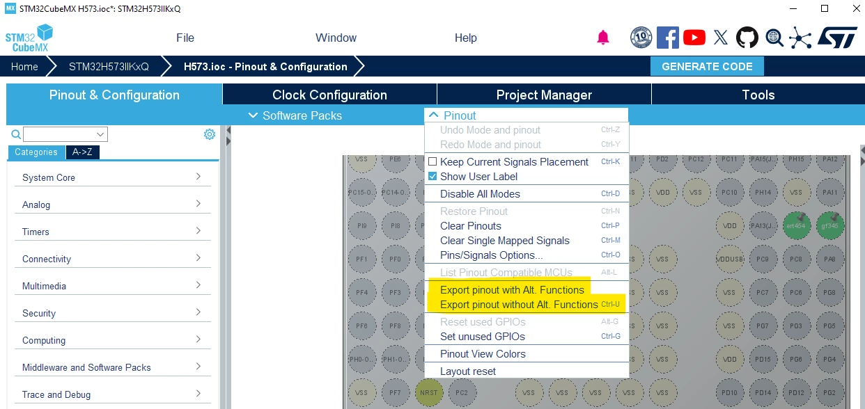

Herve PIERROT
Jan 15, 2025 1:50 PM UTC
Just to complete @Amel NASRI 's answer, as sometime the most difficult is to find the function in the tool, below the picture to find the mention menu in STM32CubeMX.
RicOsAuthor
Jan 15, 2025 2:29 PM UTC
Great ! Thanks a lot, to all the contributions. Fine with STM32CubeMX, I get what I wanted.
