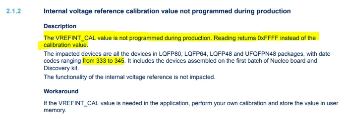

As explained in the reference manual RM0503 rev2, §14.10, the MCU has an internal bandgap voltage reference, which can be measured by the ADC peripheral. This reading can be compared to the one performed by ST in the factory (and stored in flash), so that we can infer the ADC voltage reference (VREF+).
The datasheet DS14548 rev2 says that VREFINT is (1.182V, 1.212V, 1.232V) (min, typ, max), in Table 25.
The DS also says (Table 6) that the VREFINT calibration value is found in flash @ 0x1FFF6EA4-0x1FFF6EA5, and that it is measured at 30°C+-5°C, with VDDA=VREF+=3.0V+-10mV
Also, the ADC has a resolution of at most 12-bit (I assume the measurement is 12 bits, not less, which is true for other MCU families, at least).
So, I would expect the value stored in flash to be around ([1.182V, 1.212V, 1.232V] / 3.0 * 4096) = [1613, 1655, 1682] = [0x064D, 0x0677, 0x0692]
(only occupying the lower 12 bits of the 16 bits available at the specified address).
The HAL library agrees with the datasheet: stm32u0xx_ll_adc.h defines these symbols:
#define VREFINT_CAL_ADDR ((uint16_t*) (0x1FFF6EA4UL))
#define VREFINT_CAL_VREF ( 3000UL)
However, at that address, I find 0xFFFF, as if the calibration value was never stored.
What's going on? Is it possible for it to be missing, maybe in some early revision of the MCU?

I can see that the temperature calibration values are there (@ 0x1FFF6E68 and @ 0x1FFF6E8A: 0x0405 and 0x055D).
I have 0xFFFF in 0x1FFF6EA4, and also a 0x0100 in 0x1FFF6EA0 (as well as other numbers) which I don't know how to interpret (maybe the VREFINT calibration is stored somewhere else in this vicinity?)
Also, I see a value 0x06F3 (which is plausible as the VREFINT calibration, though a bit high) at address 0x1FFF6E82.
However, on another chip, that value is identical (so maybe it's not the calibration value, after all). Its memory is the following:

Hello @SZano ,
Could you please take a look at this errata sheet and precisely 2.1.2 Internal voltage reference calibration value not programmed during production errata
Could you please share a photo of the part marking?
Thank you.

2024-09-05 8:45 AM
My package is UFQFPN48.
The date seems to be 345, so it must be this errata.
