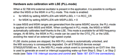

To my knowledge there is no example for MSIS hardware autocalibration. But from reference manual states the following:
So you need to use the PLL-mode hardware auto-calibration feature, ensure the LSE oscillator is connected and operational and configure the RCC_CR register to enable PLL-mode (MSIPLLEN and MSIPLLSEL bits).
