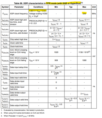

It seems that reducing the XSPI clock frequency from 200MHz to 160MHz solves the problem. However, I still do not understand why the program executes correctly from flash.

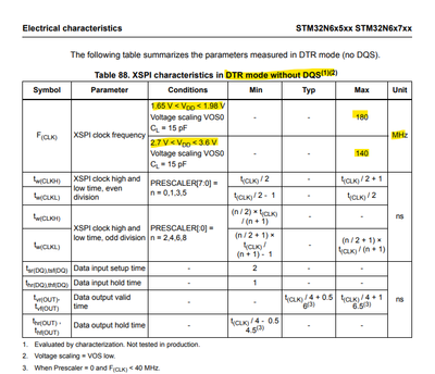

The maximum frequency of XSPI depends on several factors, including: memory characteristics, the specific STM32 devices used, OCTOSPI pins, the operating modes (SDR, DTR, HyperBus), the system clock, the OCTOSPI kernel clock... Each of these factors can significantly impact the achievable maximum frequency.
The user should refer to the datasheets of both the STM32 and the memory to find the maximum OCTOSPI frequency and the conditions required to achieve this frequency.

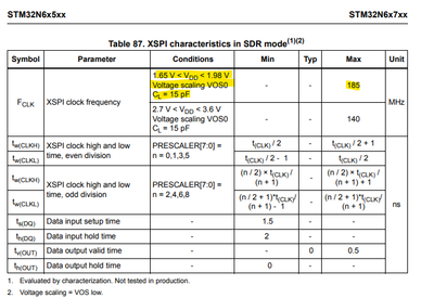

Hi. Thanks for your reply. I am using the STM32N6570-DK discovery board as mentioned. Is it designed to work with a 200MHz XSPI clock?
Artur
KDJEM.1
Hello @Artur5 ,
The STM32N6570-DK discovery board designed to support maximum frequency.

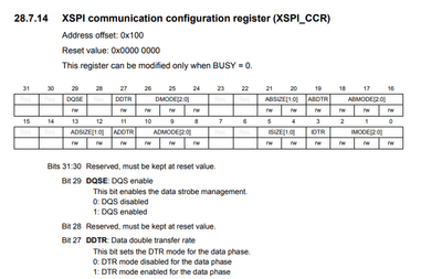

I'm asking about the software, the software must ensure that SSHIFT = 0 when the data phase is configured in DTR mode (when DDTR = 1), GPIOs is configured very high-speed.

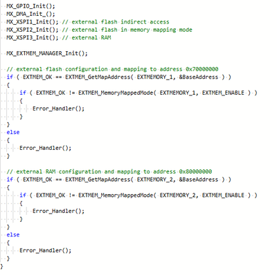

I use ExtMem Manager to configure memory. As I wrote above, the problem is only when calculating the checksum in FSBL and it is always an error in the same byte. When calculating the checksum, the next bytes from Flash are added (about 300kB). Later, the code starts executing from Flash (XiP). I have not noticed that the application has ever crashed. This is strange to me. I also see a changed byte when I stop the application under the debugger. It happens more often when the board is disconnected from the power supply for a moment.
I use multiplexed flash access. On xspi1 I have indirect access, xspi2 is mapped. Everything works very well, except for this problem with a corrupted byte from time to time.
