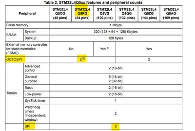

Hi, in this STM32L4Q5RGT6 microcontroller of (LQFP48) package how many SPI, QSPI should be connected.

According STM32L4Q5 datasheet; STM32L4Q5RGT6 supports 3 SPIs and maximum 2 OCTOSPIs (available only on multiplexed mode).

so can I use two spi and 1 qspi in LQFP48 package.
KDJEM.1
Yes, you can.
