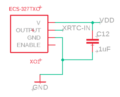

I'm designing a board for weather observations and having a problem with the RTC timing out.
I'm using a TCXO as the input for the RTC on LSE.  The particular TCXO is ECS-327TXO-2012-33-TR.
Here is the weird thing.  If the board is inside a building, my house in this case, all is good, the RTC starts up no problem.   However, if the board is outside (it's a weather instrument so it will operate outside on battery power), the RTC fails to start up, with a timeout inside RTC_EnterInitMode.
If I run the RTC on LSI then all is fine, but I need more accuracy, thus the TCXO.
Below are details on the setup.  If any further information is required let me know.
Any help would be greatly appreciated!  This one really has me stumped.
Jerry
The circuit diagram for the TCXO is:
Where XRTC-IN is connected to pin 3 (PC14-OSC32-IN) of a STM32L496RGT3.

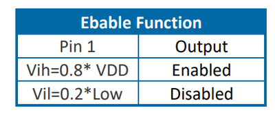

try : enable -> hi , connected to VDD.
Maybe the internal pullup is very high impedance, so even some moisture is enough to stop it working.
ds of other ECS-327 series shows :
So : better enable -> VDD .

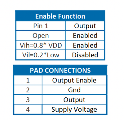

What about the pin ENABLE of the TCXO?
It wants to see a clear high level to make the TCXO work.
Regards

Hello Peter,
As per the TCXO data sheet, if the enable is left open it should be enabled.
Hi All,
Thanks for all your suggestions, they are very helpful.
Despite the fact that the datasheet says you can leave the enable pin open the problem was that is was left open.  Tying it to VDD seems to have solved the problem.
I appreciate the help.
Jerry
