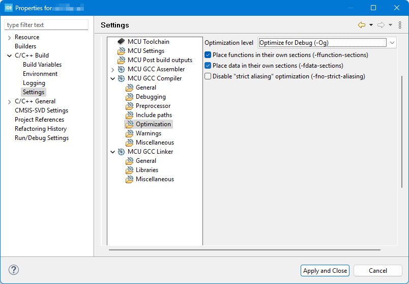

Try sorting the list by size, and look at the largest things ...
Have you tried increasing optimisation yet?
One key optimisation is that unused functions don't get included in the final image ...
GCC Optimisation levels are documented here;
https://gcc.gnu.org/onlinedocs/gcc/Optimize-Options.html
"-Og should be the optimization level of choice for the standard edit-compile-debug cycle, offering a reasonable blend of optimization, fast compilation and debugging experience" - see here.

  • Compile with higher optimization settings.

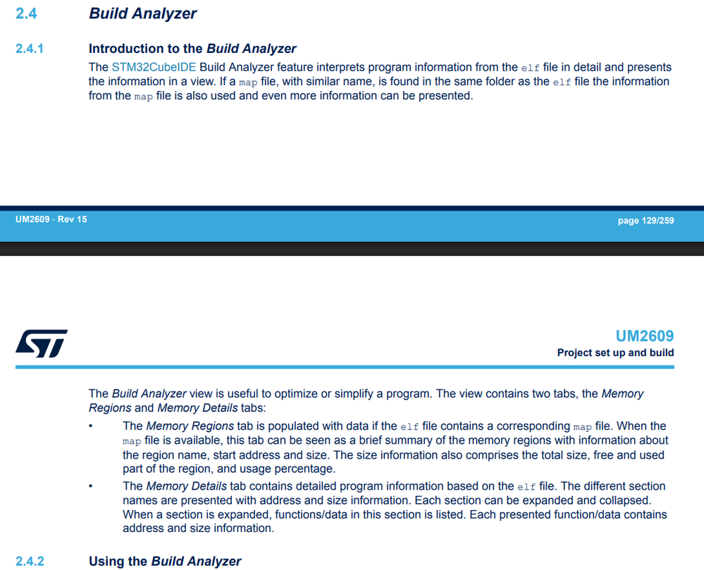

Use the CubeIDE Build Analyser to see what, exactly, is using up all the space.

As @TDK suggested, try a higher optimisation setting.
PS:
https://www.st.com/resource/en/user_manual/um2609-stm32cubeide-user-guide-stmicroelectronics.pdf#page=129

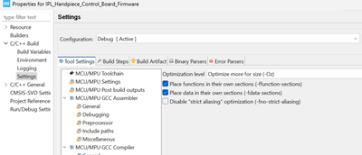

Hello @Andrew Neil,
Yes Sure,
For me I have removed some additional wrapper functions (Which were created for STM32H series Application, used in other project for some additional check and validation), now I have used simple HAL functions which are created during code generation.
Disabled and removed the I2C from .ioc , (which is not going to be used any more).
Then tried to Optimize from Properties settings to "Optimize More for size (-Oz)",
This worked well without any trouble in firmware operation.
