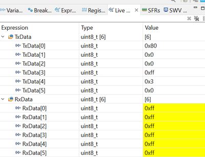

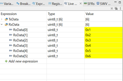

I am currently developing a battery management system (BMS) utilizing the STM32L476RG microcontroller (MCU) and the ADBMS6830 as the analog front end (AFE). Communication between the MCU and AFE is established via SPI. Since the AFE supports isoSPI, we are employing the LTC6820 transceiver. During testing, I transmitted the following data: TxData[6] = {0x80, 0x00, 0x00, 0xFF, 0x03, 0x00}, but the received data was RxData[6] = {0xFF, 0xFF, 0xFF, 0xFF, 0xFF, 0xFF}.
 Is my SPI configuration is correct or not, did I need to do anything more. Please provide some insight about this.

The debug terminal :

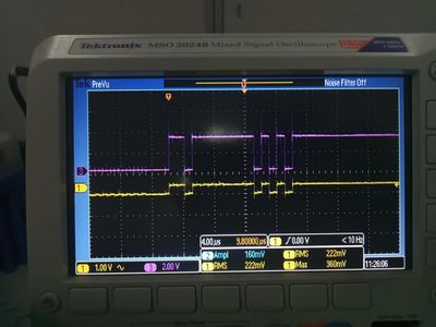

Please find the attached Oscilloscope images:
Blue : MOSI
Yellow : Clk
Pink : MISO
12 REPLIES 12
Received SPI data of all 0xFF suggests the chip is non responsive. Perhaps not powered, perhaps wires are not connected correctly.
Your SPI output of the STM32 is correct so the issue is not likely to be an STM32 configuration issue.
I'd recommend probing signals directly at the ADBMS6830. Verify chip select, clock, MOSI, MISO all look as expected.

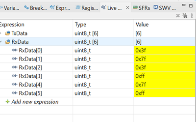

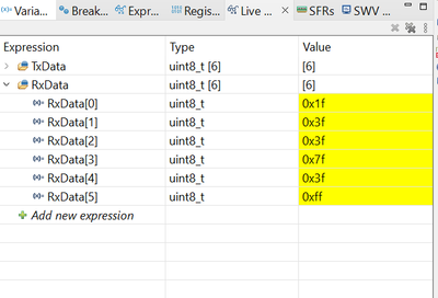

 I attempted to interface the AFE (ADBMS6830) with the STM32L476RG Nucleo board. Currently, I am receiving the transmitted data along with additional values. I need to verify if the received data is accurate.
I am attaching the debug terminal screenshots. Please provide technical insights.
1. Use TransmitReceive.
2. Read dozens of similar topics in this forum started by beginners having the same problem and look for the explanations.

I agree with @gbm
SPI Transmits and receives at the same time. As bytes are being clocked out, response bytes are clock in.
So you need to use the TransmitReceive call to send a packet which expects a response. Check the timing diagram in the datasheet for the device you are inyterfacing too, it will clearly show the expected bit timings, from which you can see excatly where and when the received bytes come in.
Does it look accurate to you? What values do you expect vs what values are you getting? Surely you should be able to tackle this on your own.

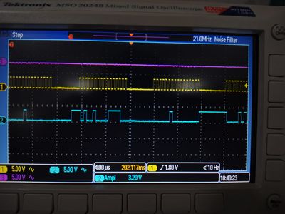

I used an oscilloscope to measure the signals, and I observed that the MISO signal mirrors the MOSI signal. However, the voltage level of the MISO signal is significantly lower. Additionally, the debug terminal consistently outputs 0xFF.
Could you provide some insights into why this might be happening?
In the above image Pink channel is MOSI & yellow channel is MISO.
That doesn't look right. If I read your scope properyl that's only about 0.5 volt on the MISO channel.
How are your devices connected? Are they on the same PCB? If not, make sure you have a common GND connection between the two, as well as the MISO, MOSI, SCK and CS lines.

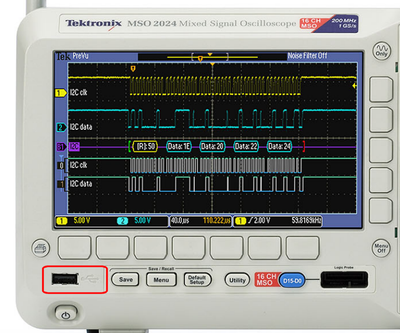

Your scope has a USB socket for capturing screenshots:
This will give you far better results than trying to take photos of the screen!
Are you sure your probes and/or scope channels are correctly configured - for x1, x10, etc?

The MCU and AFE are located on separate boards. However, I have ensured proper connections, including GND, MISO, MOSI, SCK, and CS lines.
