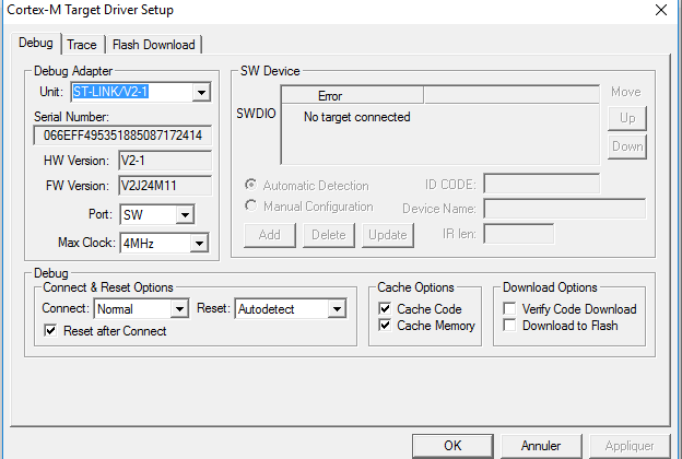

debug tab: 0690X00000605ZtQAI.png
I use as IDE keil µvision5 and I installed latest version of the linker in Keil/ARM/Stlink/USBdriver. I checked if my version was updated with ''ST-LinkUpgrade'' It's ok.

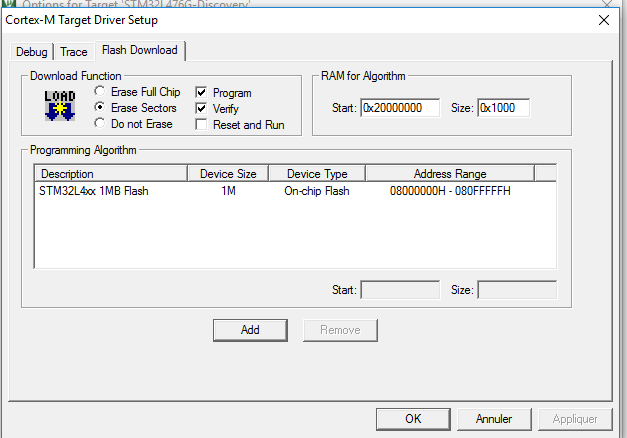

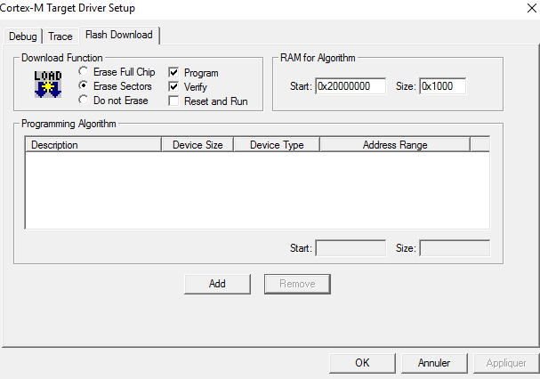

I don't understand where is my pb it seems that nothing is selected in programming algorithm but I tried with ''STM32L4xx 1MB flash'' but the problem stay...

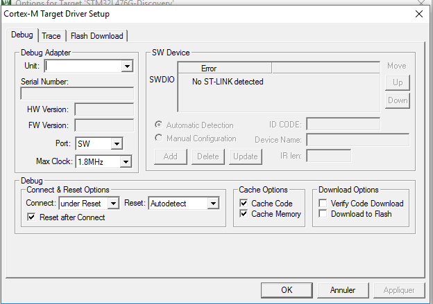

Try ''Connect : Under Reset'' option, or strapping BOOT0 High. You can't debug a device that powers down.
Will definitely need to have the algorithm selected in the menu.

Thank you, thanks to your piece of advice, I can load the program into the flash memory.
My settings according your specification:
Then
