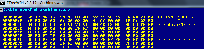

Posted on March 03, 2016 at 02:05
To create the header you'd need to know some things about the type of PCM data you are describing, including the sample rate, width, channels, byte rates, etc.
Unless the form of the data matches that expected by the output code it is likely to sound awful. You can't just slap a header on it. You could use some basic File IO routines to create .WAV files, ie fopen/fclose/fseek/fread/fwrite

in fact, the RIFF header was lower in my wav files so with notepad++ I deleted the first rows as far as I found the ''RIFF''. 0690X00000605bkQAA.png Anyway the sound is still awful. To get the fields of my wav files I used a little program:

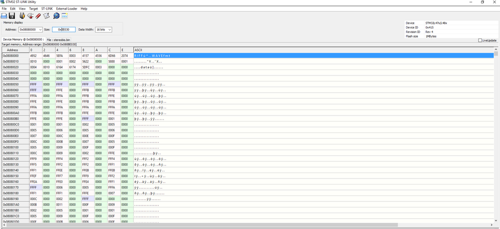

I got these fields: 0690X00000605amQAA.png Then I set the program demo provided by ST for example audio_frequency 16K so forth... However the sound stay awful I didn't find the issue.... Plz help me.

Posted on March 15, 2016 at 17:07
I managed to load two wav files without sizzle other than that available in the demo. For this four conditions are necessary (using the ST-Link utility and demo program provides ST). 1 ==> It is necessary that the file size is < or = to 500kb for a repeat loop. 2 ==> It is essential that the downloaded .wav file begins with header RIFF.WAVE nothing even erasing the first lines you can hear the sound but will be accompanied by a horrible sizzling ... 3 ==> It is imperative in line 53 of the demo program to put the size (a little less) of the file that we will inject into the flash.
#define AUDIO_FILE_SIZE (133*1024)
Ex: My file does 137Ko so I put 133 to avoid any noise because the file is played in loop. 4 ==> Comment out the line 97 or inform the beginning of entete RIFF your file.
