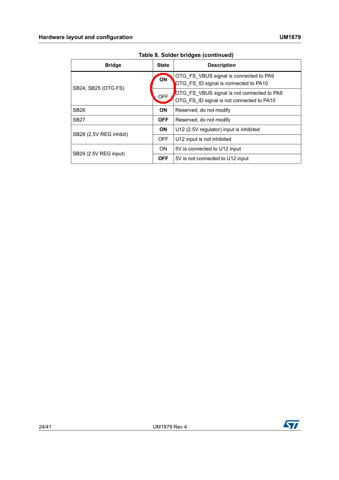

[STM32L476 DISCO docu] incorrect solder bridges description
waclawek.jan
These solder bridges are in fact by default OFF, as these signals would collide with the LCD (as text elsewhere in the same manual points out).
May I at this point ask again for a table with describing connection of all pins on the target STM32L476, as it is in the current 'F4 DISCO manual?
Thanks,
2 REPLIES 2
Amel NASRI
Hi Jan,
The error in "Solder bridges" table as well as the request to add the table " STM32 pin description versus board functions" are reported internally (to be assessed and check what can be done).
-Amel
