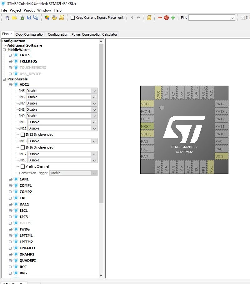

How did you set the clock input ? which timer ?
the cube selections attached:
I have a pair of clocks, the primary source goes to PA0/CK_IN with routes to TIM2_CH1 via the AF matrix. I have a secondary clock on PA5 which routes to TIM2_CH1 or TIM2_ETR depending on the AF matrix.
I can measure both (one at a time) of these on a 1 Hz interval by using TIM2_CH1 as an External Clock for TIM2, so nominally observe the TIM2->CNT advance 10 or 20 millions ticks.
I didn't see the HSE/32 option for TIM16, I'll look at it again. Perhaps via RTC clocking from HSE divided down. I'm using an L432KC (32-pin QFP) in the context.
I, like Jan, assumed some simple bonding, but not convinced that's what's happening.

Tim16 options from the Cube..
Tim16 can be activated or not... there is no selection for clock source.
Tim16_Ch1 has options shown.
Tim16 runs from HCLK.
LPTimers do not.
 ooops wrong image !
