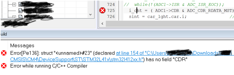

I'm finding difficult to get the value from the channel that i configured of a regular channel with stm32l412 microcontroller. where I'm not getting the EOC interrupt enabled in ADC_ISR register.
and When I tried to get data from ADC_CDR register, it throwing error on me like there no like this register is exists.
Really not understood why is happening like this.
Show the error.

‎2024-02-13 10:40 AM
How did you try ?
ADC_CDR is 32 bits and has two parts...

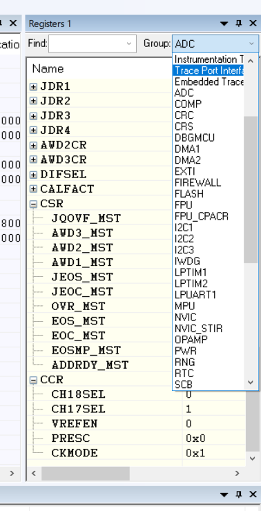

‎2024-02-14 3:10 AM
‎2024-02-14 3:15 AM
This is how i tried but, i don't know why it's happening. I have not even seen CDR register is there in registers list. Please acknowledge and respond. Your help will be greatly appreciated.

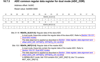

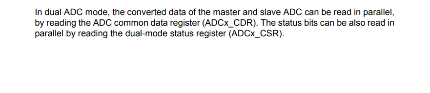

Please have a look into this. I'm trying to enable both regular and injected in ADC_CCR register so, we have to read from ADC_CDR regiser. Your help will be greatly appreciated.
‎2024-02-14 6:58 AM
The common ADC register is at ADC12_COMMON->CDR, not ADC1->CDR.
