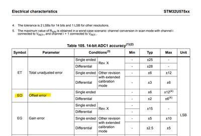

rm0456 in chapter 33.4.8. talks about "Software procedure to calibrate the ADC" and "Extended calibration mode" on some products. It is not clear, if "Software procedure to calibrate the ADC" is enough for products with "Extended calibration mode" or  if extended procedure should be done always when available?
Please clarify!

Hello @Uwe Bonnes ;
Concerning note 2. ADC DC accuracy values are measured after the internal calibration
Standard calibration for Rev. X
Extended calibration for other revision

Hello @Uwe Bonnes ;
First of all thank you for sharing this question in the community.
On STM32U5 there are different calibrations for ADC :
- The most common one "normal calibration mode" which calibrate the offset on the ADC and is depending on the device voltage.
- The extended mode is a linear calibration which improves the total harmonic distortion (THD) factor and then reduce the differential (ED) and integral (EL) linearity errors on the ADC. This feature requires more time to be active on the ADC than the normal calibration mode, but once activated it does not depend on the voltage, so you can avoid another calibration if the power voltage changes.
Both calibration are available on STM32U5 devices, and it is up to the customer to choose one or the other depending on the application.

Thanks for the answer.  However now it is unclear if " linear calibration" in extended calibration includes the offset calibration from normal mode?
KDJEM.1
Hello @Uwe Bonnes ;
According to the datasheet; Offset calibration is not impacted by extended calibration mode.

Not really. Remark (2) from the datasheet cutout you show  tells:
but which of both possible calibrations is meant?

Hello @Uwe Bonnes ;

Clarification in the datasheet is welcome...
