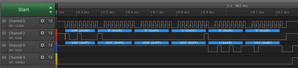

I am trying to use a Flash memory (SST25VF010A) with STM32L072 via SPI. I used CubeMX to generate to initialize code and I started a simple code to get ManufacturerID and check that SPI comunication is right. In fact, I can send data properly to the memory module and check with logical analyzer ( as shown in picture), but cannot pick it up from the bus and save it in any variable and then print it on the console.

CRodr.5
0693W000008zjbGQAQ.pngWhat a I get from logical analyzer
