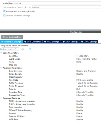

static void MX_LPUART1_UART_Init(void)
  hlpuart1.Instance = LPUART1;
  hlpuart1.Init.BaudRate = 115200;
  hlpuart1.Init.WordLength = UART_WORDLENGTH_8B;
  hlpuart1.Init.StopBits = UART_STOPBITS_1;
  hlpuart1.Init.Parity = UART_PARITY_NONE;
  hlpuart1.Init.Mode = UART_MODE_TX_RX;
  hlpuart1.Init.HwFlowCtl = UART_HWCONTROL_NONE;
  hlpuart1.Init.OneBitSampling = UART_ONE_BIT_SAMPLE_DISABLE;
  hlpuart1.AdvancedInit.AdvFeatureInit = UART_ADVFEATURE_NO_INIT;
  hlpuart1.FifoMode = UART_FIFOMODE_ENABLE;
  if (HAL_UART_Init(&hlpuart1) != HAL_OK)
    Error_Handler();
  if (HAL_RS485Ex_Init(&hlpuart1, UART_DE_POLARITY_HIGH, 0, 0) != HAL_OK)
    Error_Handler();
  if (HAL_UARTEx_SetTxFifoThreshold(&hlpuart1, UART_TXFIFO_THRESHOLD_1_8) != HAL_OK)
    Error_Handler();
  if (HAL_UARTEx_SetRxFifoThreshold(&hlpuart1, UART_RXFIFO_THRESHOLD_1_8) != HAL_OK)
    Error_Handler();
  if (HAL_UARTEx_EnableFifoMode(&hlpuart1) != HAL_OK)
    Error_Handler();
  /* USER CODE BEGIN LPUART1_Init 2 */
  LPUART1_EXTI_ENABLE_IT();
  /* USER CODE END LPUART1_Init 2 */
For testing I have tried lptimer to wakeup and it work, but it doesnt wakeup at rx interrupt.
Please help me to identify the issue.

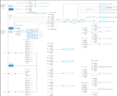

 Note: In Reset_SystemClock(); I was just calling same function of SystemClock_Config() which was generated by STM32CubeMx.
void SystemClock_Config(void)
  HAL_PWREx_ControlVoltageScaling(PWR_REGULATOR_VOLTAGE_SCALE2);
  RCC_OscInitStruct.OscillatorType = RCC_OSCILLATORTYPE_HSI|RCC_OSCILLATORTYPE_LSI;
  RCC_OscInitStruct.LSIState = RCC_LSI_ON;
  RCC_OscInitStruct.PLL.PLLState = RCC_PLL_NONE;
    Error_Handler();
                              |RCC_CLOCKTYPE_PCLK1;
  RCC_ClkInitStruct.SYSCLKSource = RCC_SYSCLKSOURCE_HSI;
  RCC_ClkInitStruct.APB1CLKDivider = RCC_HCLK_DIV1;
  if (HAL_RCC_ClockConfig(&RCC_ClkInitStruct, FLASH_LATENCY_1) != HAL_OK)
    Error_Handler();
So, I just need correct way for waiting this hal ticks to wakeup correctly, instead of adding this delay.

This doesn't solve my problem, But I have done some workaround to wait for systicks to wake up and then go ahead.
 HAL_SuspendTick();
 HAL_PWREx_EnterSTOP2Mode(PWR_STOPENTRY_WFI);
 HAL_ResumeTick();
 //HAL_Delay(1);
 uint32_t t0 = HAL_GetTicks();
 while(t0 == HAL_GetTicks());
So, this solves the problem, but again it looks like workaround.
