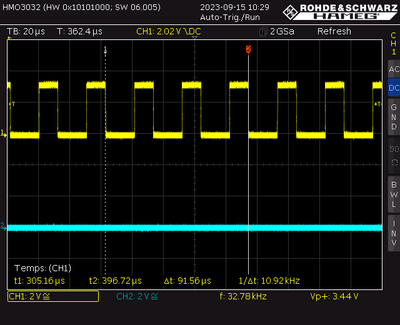

When i check my bauds rate on my oscilloscope, i get the value of 93.3 that represent ~10718 bauds.

If you measure individual bits, you can only measure integer periods of the 32768Hz LSE clock, i.e. the calculated "baudrate" from individual bits can be for 9600 setting only 32768/3=10922 or 32768/4=8192. LPUART achieves a relatively good 9600 Bauds by dithering, i.e. alternating appropriately between these two bit lengths.

Hello AScha.3,
This my return after your reply:
1) Frequency is correct, Picture below get from MCO output
2) I have try in High LSE drive capability but nothing change.
