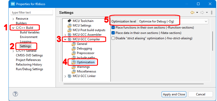

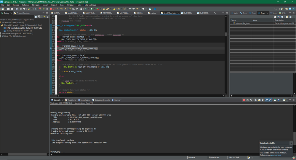

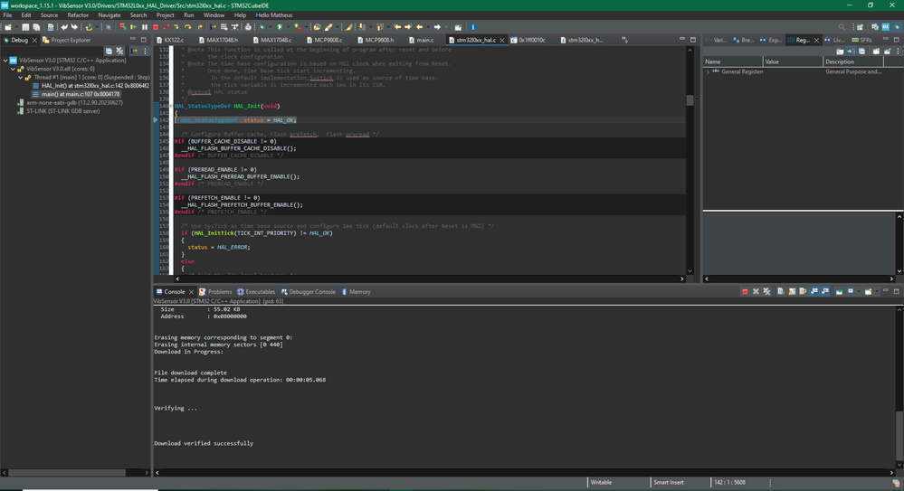

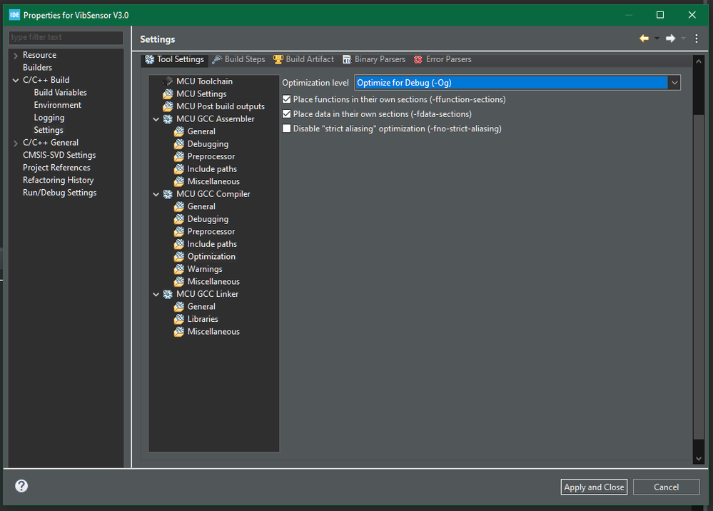

  • Firstly, my code is only executed by the chip when the system finishes uploading and resets it. I added an external 10K pull-up resistor to the chip's reset (which wasn't on the PCB). Now I can run the code whenever I pulse GND on the pin. However, it should run whenever the system is connected to power, which is not happening.

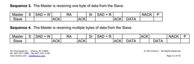

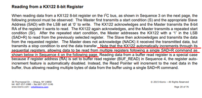

  • Secondly, my code is crashing in the accelerometer reading loop, basically I added a loop that reads the accelerometer 2048 times during one second, spacing the readings with a microsecond delay calculated in the setup method. The loop code runs well up to about 30 samples and then stops. I've tested the delay separately and apparently it works. And I've tested the loop with no other code in it, just the delay, and the same error happens.

Apparently it crashes when initializing the "status" variable in the first line of HAL_Init, which is pretty weird, right?
Update: Apparently now when I restart the chip manually it manages to run through the for, but crashes after a few executions of the loop method.

By crash I mean that it stops sending signals via the UART debug, and only comes back if I restart it. By the last signal it sent I can tell where it stopped.
How do I see it? Sorry, I'm a newbie to STM32 :eyes:
In the Project Properties:
I put it on the same way:
