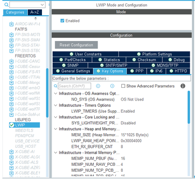

The CubeMX configurations are as follows:
CORTEX_M7 configurations
ETH configurations
LWIP configurations
Problems Encountered When Cache is Disabled
1. Usage Fault: The device enters a Usage Fault error when the program execution branches into the function SCB_InvalidateDCache_by_Addr() within the following call stack:
ethernetif_input() > low_level_input() > HAL_ETH_ReadData() > HAL_ETH_RXLinkCallback()
2. Bus Fault: A Bus Fault error occurs during a memory copy operation from the IP header address within the following call stack:
MX_LWIP_Init() > ethernet_input() > ip4_input() > ip_addr_copy_from_ip4()
Workaround
The issues are not observed when SCB_DisableDCache() is called immediately after HAL_Init(), even though the Data Cache is already disabled in the CubeMX configuration.
However, the problem persists under specific conditions:
  • Errors are still encountered when debugging is entered for the first time without the device's power being cycled.
  • The problem does not appear when the device's power is cut and debugging is entered immediately afterward.
  • The error is not observed when debugging is entered after the device has been powered on and off a few times.
(This behavior was tested by defining counters saved in EEPROM within the respective fault handling functions.)
