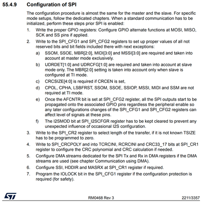

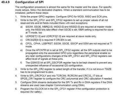

The Reference Manual example you provide here is quite readable. The SPI section for the STM32H723/733 device appears to be a clumsy translation from technical writing in another language. I understand the configuration. I do not understand what the action sequences are for any of the major functions. Eg: do we release CS# after every instruction?
It is your choice. Use CS how you want. It can be controlled by hardware or by you control it manually using it as a GPIO output. Generally, GPIO output is preferred but the STM32H7 also has proper hardware support for controlling CS.
Are we looking at the same thing? Here's a screenshot from the current RM available online. I don't see much difference between this and what I posted in the last thread.
I have no interest in writing or debugging LL code, but if you want to use direct register access I can help (by reviewing code, not writing it for you).
