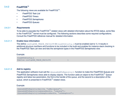

I am searching for any documentation or tutorial on how to use debug tools i.e FreeRTOS, SWV etc.

Please review the UM2609 "STM32CubeIDE user guide" / Section 3.4.2 FreeRTOSâ„¢
