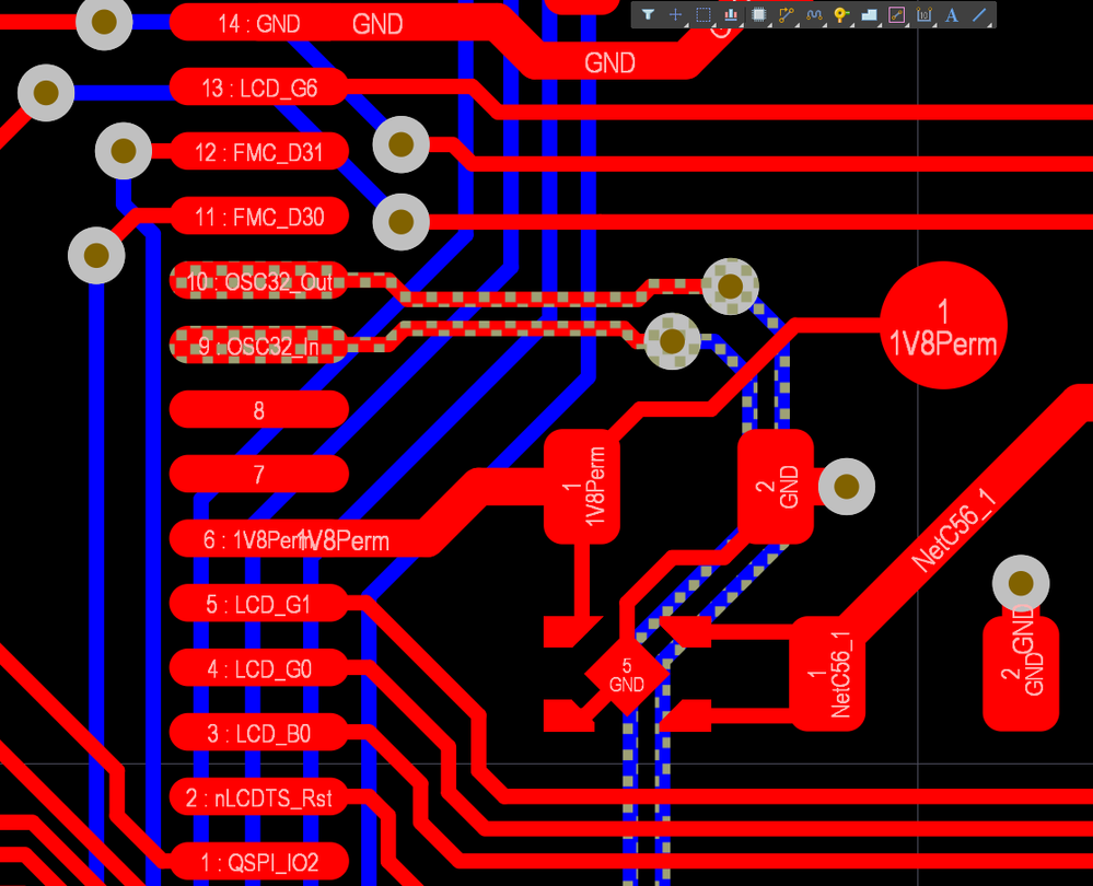

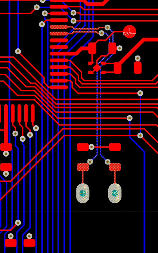

franck23
Senior
I had issues with the RTC which would lose around 1sec per minute when other peripherals were running.
In my case, lowering the oscillator capacitors did the trick (clearly, I had it easy compared to others!)
I am posting my setup so that it can be re-used.
Here is the board setup:
  • STM32H743 Rev V, LQFP 176, 480MHz
  • 32.768kHz oscillator: Abracon - AB38T-32.768KHZ, 20ppm, 12.5pF
  • OSC32 capaciors: 3.3pF, no series resistors
  • SDRAM, 32bits bus, 120MHz
  • TFT LCD 24bits, 51.2MHz
  • QSPI, 240MHz
4 Layer board, 1.6mm:
  • L1: Top Layer (red),
  • L2: Ground plane (not shown)
  • L3: Power plane (not shown)
  • L4: Bottom Layer
As you can see in the pictures above, the SDRAM and the LCD tracks are all around the osc32 signals. However, most of them are on a different layer and separated by the ground plane (not visible in the pictures).
I do not have guard around the oscillator and there is no copper flooding under it.
The oscillator tracks are 20mm long.
The ground and power layers are not split under the oscillator signals.
Oscillator capacitors are connected by a common via to the ground plane.
There is no ground separation with the other devices, but there is appropriate decoupling located less than 3mm of each power pin.
I hope it can help!
If I understand, the oscillator comes out as a pair, goes below then comes back to the top, then the pair terminates at the capacitors then tracks a little more to the crystal. No doubt adding PCB capacitance, which you adjust for by reducing the values of the capacitors. I would have tried to keep everything closer to the uC pins (or at least the capacitors closer) but that is interesting you show that the oscillator is much more tolerant than any manufacture would admit to. Also that you use the port pins on either side of the oscillator pins rather than connect them to 0V to form a guard ring.
