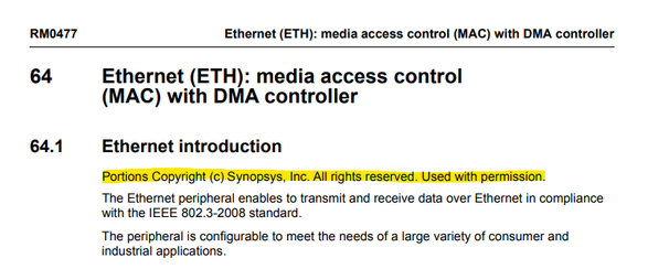

The ethernet is licensed from our partner. So, the coding order is provided by our partner.
