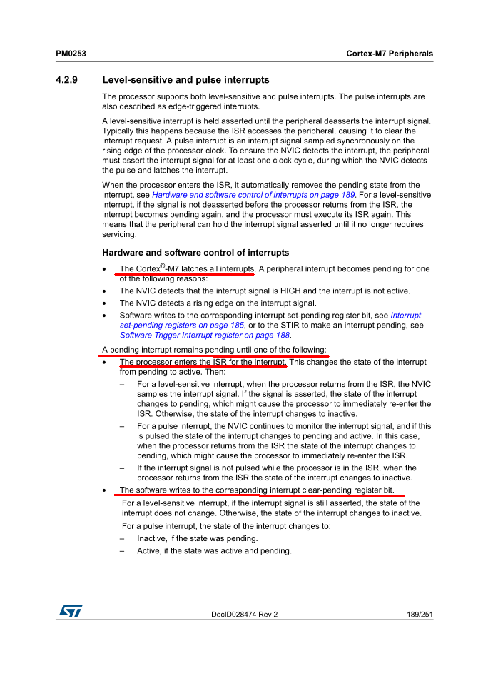

As Jan and others wrote, H7 is complicated. There can be delayed/buffered writes that require explicit flush (DSB) and even this not always is enough, requires a read-back or even worse.
IMHO your experiment with added delays is not 100% convincing.
To avoid wasting time IMHO you only need to check that unknown cases in shared EXTI hander go away in "short" time : there are no more than N handler calls in a row, before a good handler call.
Your diligence is a good thing but here you're chasing a known chupacabra.
waclawek.jan
> I assumed that the code in the HAL GPIO External interrupt handler was sufficient to clear ALL of the necessary register bits
It is, but only if you are executing the ISR. But from non-interrupt context, you have to explicitly clear also the NVIC pending bit (see NVIC_ICPRx register). This is what I quoted above: if the interrupt kicks in, it clears this bit in hardware; but if it's not the interrupt context, you have to do it yourself.
So the procedure is:
  • clear the interrupt source (by writing to EXTI pending register)
  • wait - this is the tricky part
  • clear the NVIC pending bit (by writing to NVIC_ICPRx, for which CMSIS provides the NVIC_ClearPendingIRQ() function)
  • here wait shouldn't be necessary, but I am not entirely sure
  • enable the interrupt in NVIC

I think? I've figured it out.
For an interrupt from say a DMA controller when a transmission is complete or there is an exception (error) the interrupt is raised in the NVIC and when the interrupt gets serviced the interrupt handler sorts out which interrupts were triggered at the peripheral level, executes handler functions if defined, then clears the peripheral interrupts. When the interrupt request function is returned by some magic the NVIC pending/active reg's clear and no more interrupts until the peripheral says so.
The multi-input interrupts on return however do NOT appear clear the interrupts in the NVIC reg's. So that on returning from the interrupt you get some more unsolicited interrupts.
What you seem to have to do is check all the multi-input interrupt flags and then after doing your stuff, execute a
NVIC_ClearPendingIRQ(EXTI9_5_IRQn)
statement.

  /* Clear NVIC Interrupts for these lines */
  NVIC_ClearPendingIRQ(EXTI9_5_IRQn);
This seems to do the trick.
