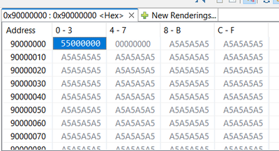

Hi Community,
During a project we are using the microcontroller STM32H7B0RBT6 with QSPI PSRAM APS6404L-3SQR , it works fine in indirect mode either in quad read and quad write, but the issue is with the write in memory mapped mode when trying to write less than 8 byte, one for example (*((uint8_t*) (0x90000010))=0x55;) the 7 others  bytes are zeroed it seems that the write accept only 8 bytes if the data is less than 8 the other bytes are zeroed as you can see :
instead written 8 bytes (*((uint64_t*) (0x90000010))=0xA5A5A5A5A5A5A5A5ULL;) works fine !!
Did someone face a similar problem could please provide some suggestions to do, thanks,

There is an errata "Memory-mapped write error response when DQS output is disabled". So with this errata we need to enable the DQS when doing memory mapped writes even if the memory do not support DQS. This is the workaround as you did.
So when you do a 8-16-32 bit write , the OCTOSPI will output 64-bit and mask the rest using DQS pin. The problem is if the memory do not support DQS (which is in our case), the rest of the AXI data will be written to the memory. so if you write : (*((uint8_t*) (0x90000000))=0x55;) 0x90000000 will be written correctly but the data from address 0x90000001-0x90000007 will be corrupted.

So you confirm there is no way to write less than 8 bytes with memory mapped mode activated,
We need this info cause this memory will be used as heap in a project where we will allocate  different sizes of Data .

There is a Memory Mapped Write limitation with QSPI SDR on STMH7A/B. If possible you  might want to consider OPI PSRAM (11 pin instead of 6, but up to x4 bandwith). The OPI version of APS6404L-3SQR is APS6408L-3OBM-BA (3V also available in 128Mb APS12808L-3OBM- BA)

This MCU is supporting Octal PSRAM (x2), or do you mean it's not available on your board ?
If you wish to stay with lowest pincount, QSPI DDR is also supported, such as APS12808O-DQ-WA
With QSPI SDR, Memory mapped write is not supported

This memory require a specific refresh value that resolve the issue, now it's working fine and stable with the memory mapped mode, we have actually used as a heap for our application contain the frame buffer and all others data
to make it work, you need to:
- Configure the MPU for the specific mapped addresses area
- Pay attention to the refresh value ( should equal 241)  when initializing the octospi interface to have better stability for values stored in this ram
