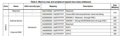

  1. What is the correct memory-mapped base address that should be used for the S80KS5123GABHB020 DSRAM on STM32N657X0H3Q1 ?
  2. Is the memory accessed through the XSPI1  memory-mapped region, and what is the exact address range?

For addresses mapping, I recommend you to look at RM0486 Rev 3 Table 2. Memory map and peripheral register boundary addresses.
When configured in memory-mapped mode, the external SPI device is seen as an internal
memory. Note: No more than 256 Mbytes can be addressed even if the external device capacity is larger.

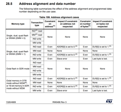

Also, I advise you to check 28.5 Address alignment and data number section in RM0486 Rev 3.
