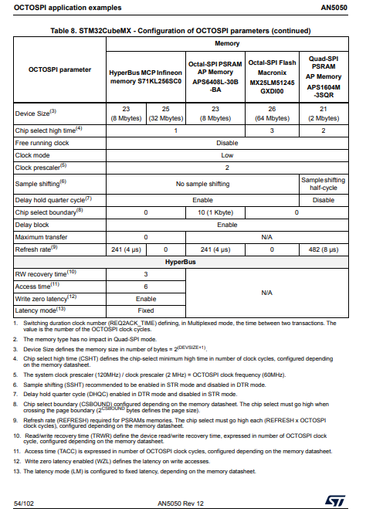

KDJEM.1
Hello @nkartik;
Could you please check your OCTOSPI configuration and precisely Read/Write recovery time, access time and Latency. For that I recommend you to look at AN5050 Table 8; may help you.
Thank you.
Kaouthar
nkartik
Hi, Thanks for your response.
Parallel to waiting for a response here, we dug deeper and found values that actually solved the problem stated above.
-  hospi1.Init.ChipSelectBoundary = 0;
+  hospi1.Init.ChipSelectBoundary = 10;
-  hospi1.Init.Refresh = 0;
+  hospi1.Init.Refresh = 40;
-  sHyperBusCfg.WriteZeroLatency = HAL_OSPI_NO_LATENCY_ON_WRITE;
+  sHyperBusCfg.WriteZeroLatency = HAL_OSPI_LATENCY_ON_WRITE;
Thanks for your support.
KDJEM.1
Hello @nkartik ;
Glad to know that the issue is solved and thank you for sharing the solution.
Kaouthar
