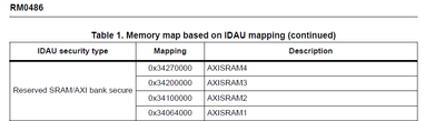

Currently, we have configured the LTDC framebuffer address at 0x34000000 and also tested with 0x24000000, but in both cases the RGB signals are not becoming active.
Since the STM32N6 has 4.2 MB of internal RAM, could you please confirm which internal SRAM region is recommended for the LTDC framebuffer?
Specifically:
  • Should the framebuffer be placed inside AXISRAM1 secure SRAM .
  • Or is there a preferred non-secure SRAM region for LTDC?
  • Are there any MPU or cache configuration requirements that must be applied for LTDC to generate RGB signals?
Looking forward to your guidance.

Hello @siddum ,
1. Do you run a secure or non secure project? (We do not provide any non secure project with N6, the TBS we have on TouchGFX are secure and using AXISRAM secure memory ranges).
2. Do you run "eXecute In Place" or "Load and Run" application?
3. Are you sure your screen is correctly configured and can show pixels? (without TouchGFX)
Osman SOYKURT
