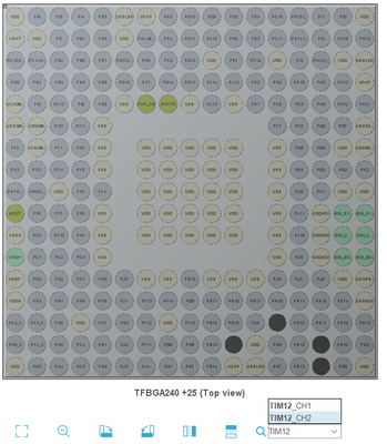

When I make a search with TIM12 wording in the pinout menu I get only Four GPIOs options PB14/PB15/PH6/PH9 which is inline with the datasheet.
No PH5 is highlighted:
mƎALLEm
@Tesla DeLorean: reported internal ticket 184676 regarding the miss of TIM12 AFs in the "alternate functions tables"

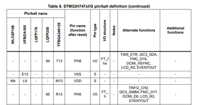

H743 datasheet is the reference (TIM12 AFs are mapped on AF2) and CubeMx from my side (at least with TFBGA240) is not showing an issue. It's inline with H743 datasheet. Knowing that H757 datasheet TIM12 AFs are well shown in Table 8. STM32H757xI pin/ball definition.

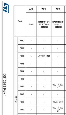

In H745 ds it is on PH9 :
>> I chose PH5 (Timer12 Channel 2) ... Alternate function is available for PH9

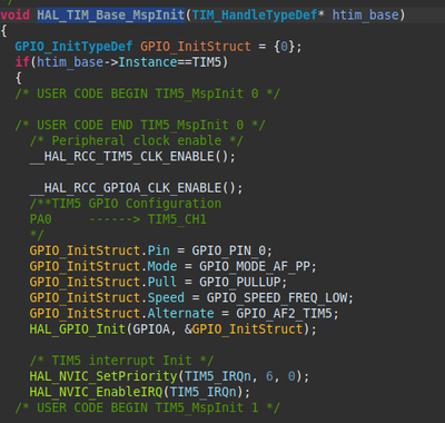

So if you generate the setup with Cube , but it (wrong) gives you PH5 for TIM12ch2 , generate code,
then modify in xxx_hal_msp.c -> TIMxx init the H 5 pin to H 9 , looks like here for PA0 + TIM5 (on my H743) :
And check/set AF is AF2 .
Try...and then check: TIM12 signal on PH9 there ?

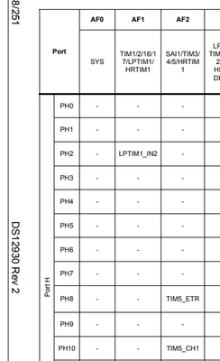

Right, Table8, pin shows:
but AF shows nothing about TIM12, it forgotten here :
So Table 16 needs little correction.
