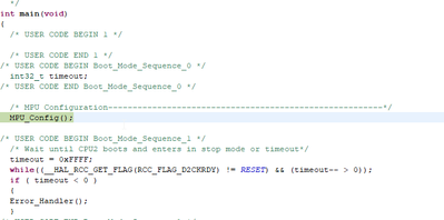

With that configuration when I launch CM7 first, then CM4, both pause as expected with CM4 in reset and CM7 ready to go. When I select both cores then click on the green go arrow, CM7 runs straight into this:
Caused by the timeout expiring.

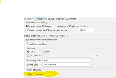

However, I have found that if I set the CM4 in the mode shown below then I can proceed without having to disable the CM7 timeout check:
I'm OK with this, since I have a solution that works.
Thanks again for your help.

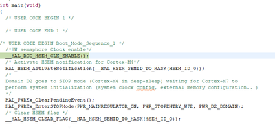

‎2025-03-06 7:06 AM
If you check the halt all cores, the best is to avoid launching both cores.
1. Start the M7 debug => the M7 and the M4 are both halted at the beginning of their main.
At this stage, in the debugger you just have the M7 target:
2. Start the M4 debug => Hot attach to the M4 which is halted at the beginning of its main function.
3. Start the M4 => it goes in stop mode
Here you get a dummy screen => don't give attention to the address given, just keep in mind that the M4 core in in stop mode.
4. Now you can start the M7. It will execute the HAL init and the config clock and continue running or stop on the next breakpoint.
5. Resume the M4.
At this stage, both cores are running.
