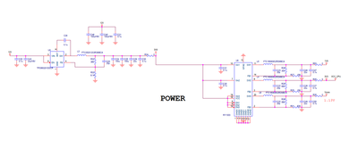

The power supply module:
  • The power supply is designed with 12V input, generating 3.8V, 3.3V, 1.8V, and 1.13V.
  • 3.3V powers the STM32 VDD pins, and 1.13V powers the VCAP pins.
  • Each VCAP pin is decoupled with a 0.1 µF capacitor in parallel with a 4.7 µF capacitor (located close, but not on the same plane due to vias).

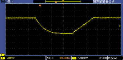

Using an oscilloscope, I checked the power rails:
  • 3.8V and 3.3V → stable, no obvious ripple.
  • 1.13V (Vcore) → shows a significant voltage dip during the reset(waveform attached).

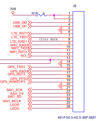

Additionally, I noticed that the problem only occurs when the external connector — which normally distributes 3.8V to other boards — is left unconnected. When the connector is attached (and the system is powering another board), the issue does not appear. Here‘s the connector interface:

I tried switching to the internal LDO regulator, but unfortunately I couldn’t get the MCU to start up properly in that mode.
Based on your reminder, I went back and checked my external Vcore supply design more carefully. I then realized that the decoupling capacitors on the VCAP pins were placed very far from the MCU pins — more than the distance of about 25 pin pitches, and connected through vias. This may have caused instability on the core supply. I am now correcting the placement of these capacitors (moving them closer to the VCAP pins) and will run further tests to see if this resolves the issue.
