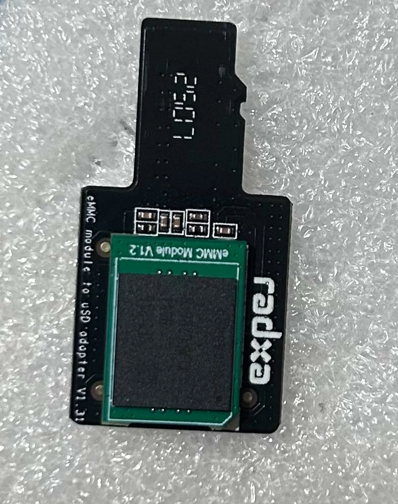

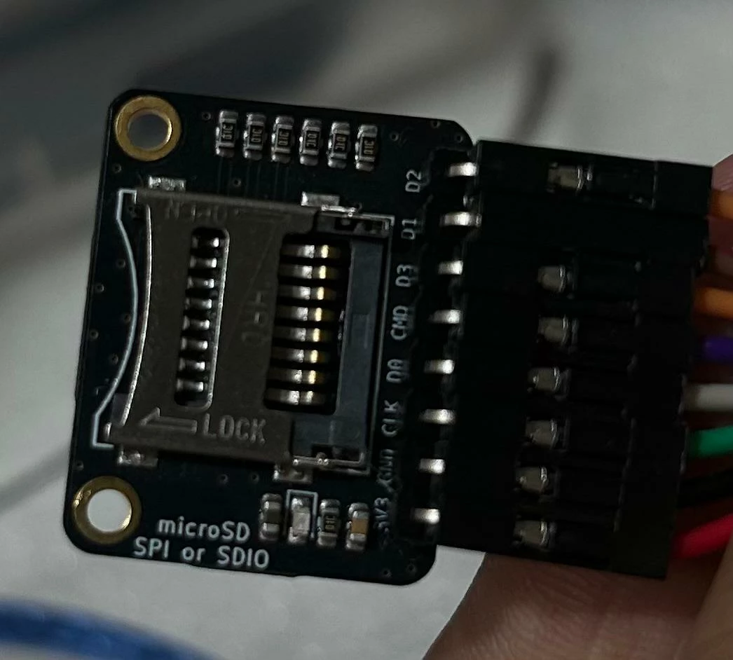

I am seeking guidance on how to interface and access a Radxa eMMC Module, which operates on the eMMC 5.1 specification, with either the STM32H750B-DK development kit or the WeAct Studio STM32H750VBT6 development board. I also have a Radxa eMMC to uSD converter, which allows the eMMC module to interface via a microSD card slot. Any suggestions or step-by-step guidance would be greatly appreciated, as I aim to integrate this storage solution into my project.
WhatsApp Image 2025-05-12 at 16.45.34_e1f2ad09.jpg    WhatsApp Image 2025-05-12 at 16.46.49_45bbde0a.jpg
  • Since the WeAct board has a microSD card slot, can I directly insert the Radxa eMMC module (via the eMMC to uSD converter) into this slot and access it using the STM32’s SDMMC peripheral?
  • Are there specific configurations or drivers required in STM32CubeIDE to initialize and communicate with the eMMC module through the microSD interface?
  • Are there any known compatibility issues with the eMMC 5.1 protocol when interfaced via the uSD converter on this board?
  • How should I configure the SDMMC peripheral (e.g., 1-bit, 4-bit, or 8-bit mode) to ensure compatibility with the eMMC module through the uSD converter?

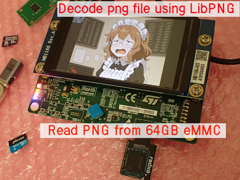

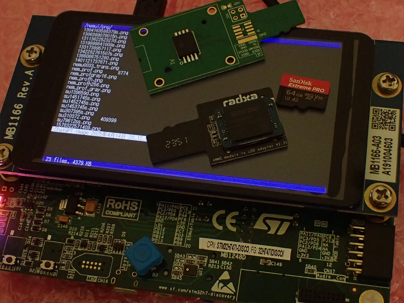

I also have Radxa eMMC to uSD converter with Chinese 64GB eMMCv5.1(Look attached picture).
I've implemented eMMC & integrated with SDcards handlings to STM32H747I-Disco with FatFs.
Here is my GCC project(notice: NO-CUBEIDE and NO-CUBEMX,makefile build only).
https://nemuisan.blog.bai.ne.jp/?eid=192848#STM32H7
SDMMC with IDMA for FatFS implementaion(may be what you want)is found my project directory inside.
./lib/ff/sdmmc_stm32h7.c
./lib/ff/sdmmc_stm32h7.h
It is not so difficult to migrate other STM32H7,enjoy STM!
