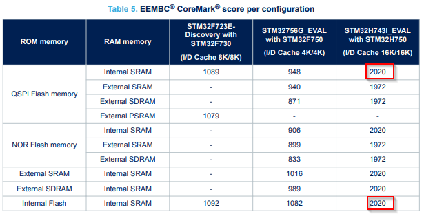

0690X0000089JYbQAM.pngThe mentioned AN5188 contains the table I completely don't understand. According to it the performance while running over the internal Flash has the same CoreMark while running over the Quad-SPI, which does not make sense. Even using 2 QPI chips as you yourself explained it takes 1 byte per clock edge, but the instructions are of 4 bytes long, so that translates to /4 slower, so how it is possible that the CoreMark is the same?
This depends heavily on the benchmark and on the precise setup. If the benchmark spends most of the time in tight loops, cache is enabled, and the QSPI address range is marked as cacheable, it's quite possible that there is no significant penalty. Additionally the QSPI has some sort of prefetch mechanism (the details lie in the dark, however), so even short forward branches might have litte effect, but that's pure speculation.
That's why I said that the impact is (almost) impossible to predict. I'm afraid you have to test with your actual application. If performance gets an issue, the first try would be placing only pure code in the QSPI flash, but constant data, tables etc. which are accessed often and at random in RAM. The last resort would be to move all data and code to RAM when booting.
