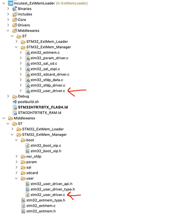

‎2024-07-28 5:21 PM - edited ‎2024-07-28 8:49 PM
I was snooping around and I found out that I could configure the external memory manager to use user drivers. I have trouble deciding where to put the driver. Should I put it in the stm32_user_driver.c file under the Middlewares folder or under the ExtMem_loader subproject?
Also is there any documentation for the external memory manager? I have seen this article (https://wiki.st.com/stm32mcu/wiki/Getting_started_with_External_memory_Manager_and_External_memory_loader#External_Memory_Manager) but that seems to be the only thing I can find.

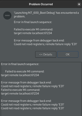

‎2025-07-15 7:35 PM
Hello Guys
some one of you can program the STM32H7R7I8T6 whit only use the internal flash? (like a normal microcontroler without the external memory) because i need to use this wreat uC whit only the internal flash, but i canot use this, i do know whay, i only have a mensaje and i canot concet to program or debug the STM32H7R7I8T6 whit the stm32cubeIDE and the st-Link/V2 (whit other microcontrolres work very well like the stm32f429, stm32H747bi, in my customiser PCBs, etc)
this is the mesnger that i get whit i tray to program or debug the STM32H7R7I8T6:

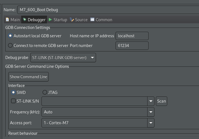

and this is the basic debug configuration i use
