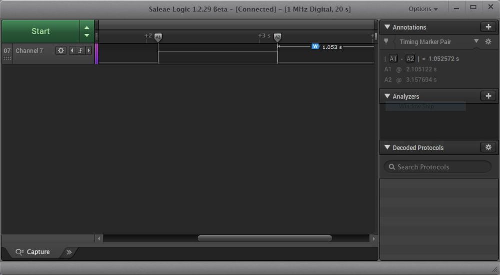

0693W00000D1SppQAF.jpgI had using STM32CubeIDE to generate ADC1 single channel with Timer 6 trigger on 1sec. In HAL library, everything work perfectly and I can see ADC interrupt happen exactly on 1sec interval. But when switch to LL library, same project but the interrupt happen slightly delay, like 1.052s. Just curious what's causing this? can anyone point me out. Thanks

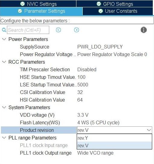

> LL_RCC_HSI_SetCalibTrimming(32);
Comment out this line and try again.

waclawek.jan
Using HSI as primary clock instead of HSE?
For this simple demo example,
I did not enable external clock.
But I don't think this could be the issue.
As same setting, HAL vs LL should give same result.
Unless something is miss on the LL Code.
waclawek.jan
Read our register content of TIM and ADC in both versions and compare.
Set just the timer alone, to see whether difference is in timer's settings or ADC's.
SEng.1
Thanks and it's work!
Could you explain why this need to comment out?
The LL library has a history of setting the wrong HSI calibration value, which makes your clock off by a few %, enough to throw off the UART communication. By commenting it out, you use the default, correct value which is set when the chip comes out of reset.
If you go to the reference manual and look up what the default value is, no doubt it is not 32 but maybe 16 or 64.
Please mark the post that helped you as the best answer if you feel it solved your issue.
Thanks for your explanation. I had marked the best answer.
SEng.1
Thanks @TDK​ for point out the problem.
I found out that I had mistakenly set the product revision to Y instead of V.
Set it to V revision solve the issue.
