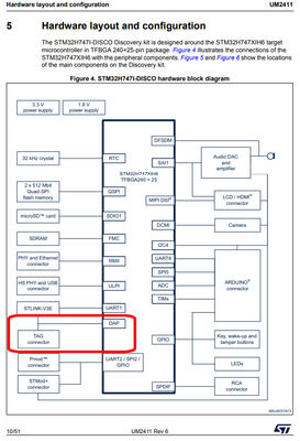

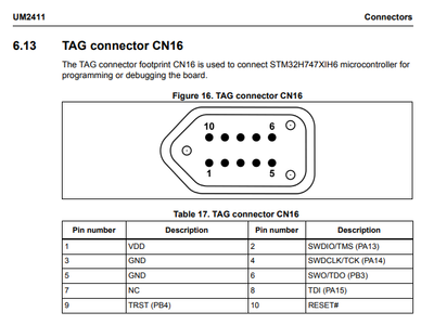

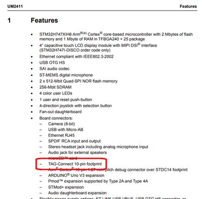

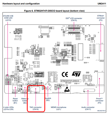

@Heisenberg wrote:
I can't find any documentation to the purpose of the connection. Thanks for any help.
It's in the User Manual - UM2411:

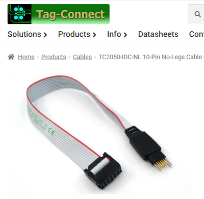

So it's a TAG-Connect 10-pin footprint.
This is a 10-pin TAG-Connect:
https://www.tag-connect.com/product/tc2050-idc-nl-10-pin-no-legs-cable-with-ribbon-connector
Details relating to J-Link:
https://www.tag-connect.com/debugger-cable-selection-installation-instructions/segger-j-link
https://www.segger.com/products/debug-probes/j-link/accessories/adapters/10-pin-needle-adapter/
"DAP" is the Debug Access Port
The "TAG Connector" is here:
The pinout is here:
