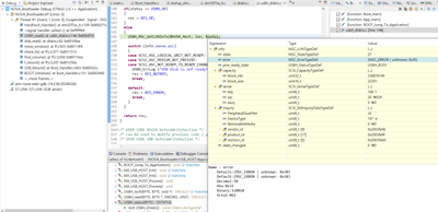

I have a STM32F7 and I use USB MSC without RTOS.
When debugging with JTAG after connecting the USB memory, a hard fault occurs as follows.
*Check Appli_state = APPLICATION_START in USBH_UserProcess() before f_mount()
HAL version(MCU package): 1.17.2
FATFS version: R0.12C
What am I missing or could I do more of?

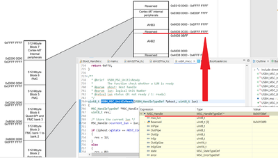

While debugging, I saw the following:
Is this due to poor STACK / HEAP Memory configuration?
